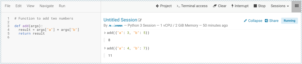

Before deploying the model, test it by running the
add_numbers.pyscript, and then calling theaddfunction directly from the interactive workbench session. For example:add({"a": 3, "b": 5})

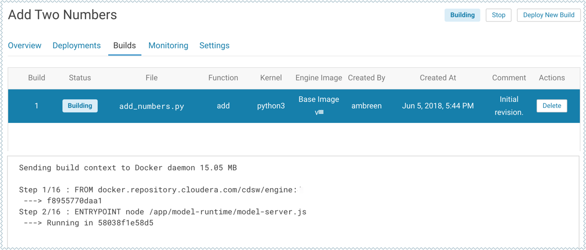

Click on the model to go to its Overview page. Click Builds to track realtime progress as the model is built and deployed. This process essentially creates a Docker container where the model will live and serve requests.
