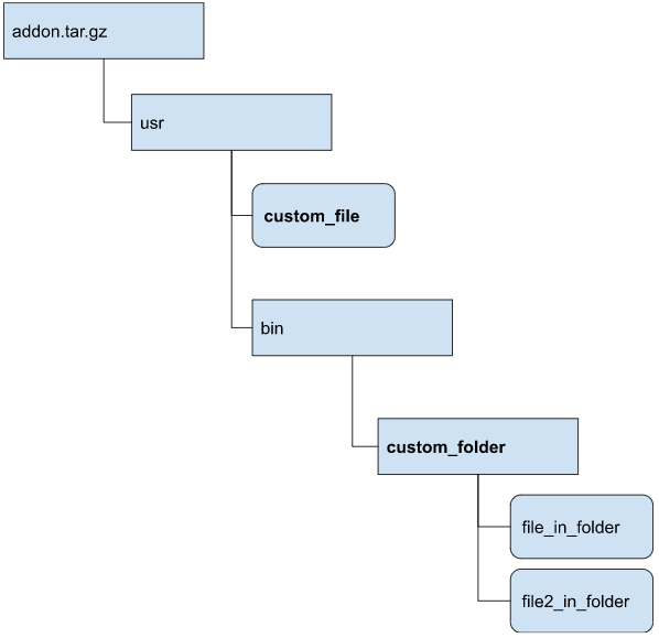

- You must create a structure of files and folders that follows the pattern shown here, and
package it as a tar.gz archive. For example, to mount a folder called
custom_folder, with all of its content under
/usr/bin/custom_folder, and custom_file at
/usr/custom_file, the internal structure of the tarball should look like
this:
