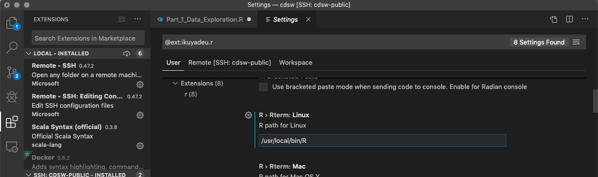

Prior to installing the R extension, check where your R binary lives in CDW by running
which R and then pasting that into the R > Rterm:
Linux setting in VS Code.
The R binary is most likely located in /usr/local/bin/R, but its best
to check.

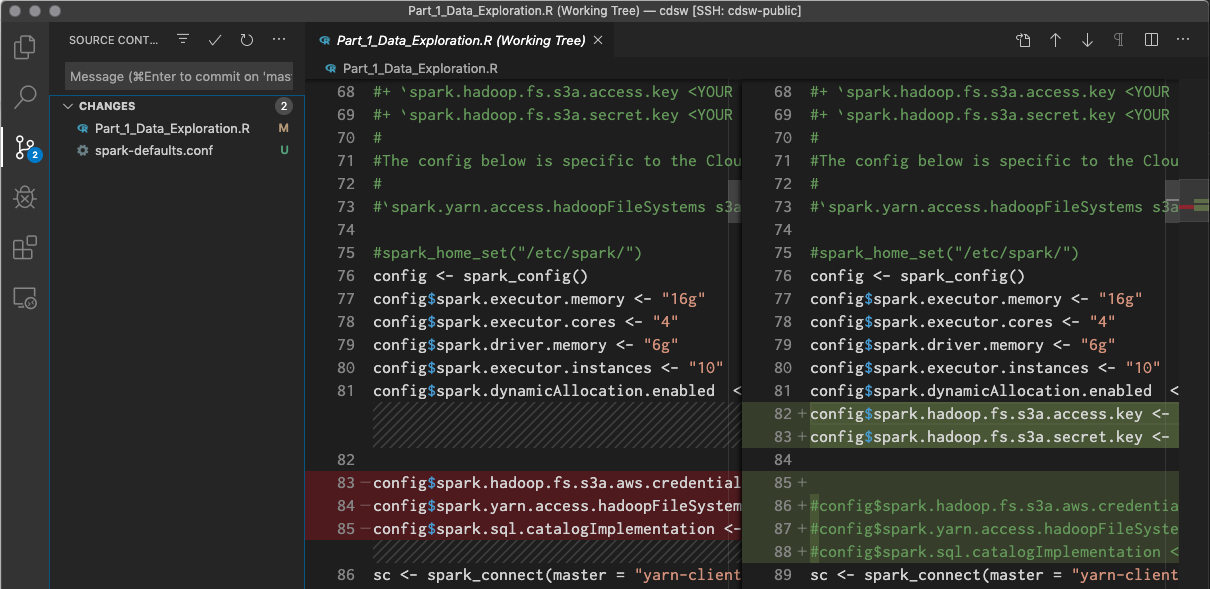

After you install the R extension, you can use sparklyr to run spark code using R
inside VS Code.
