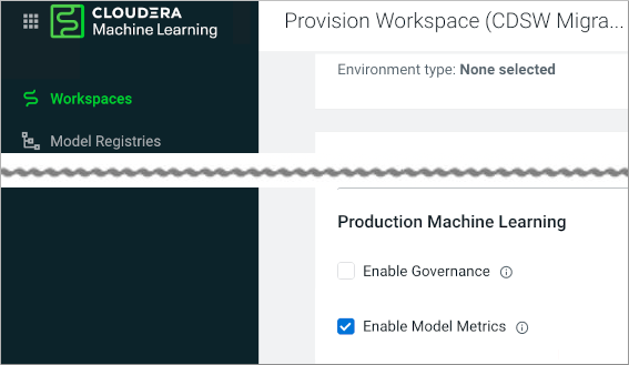

Migration from CDSW fails if Enable Model Metrics is not selected
CDSW to CML migration fails if you do not select the Enable Model Metrics option.
