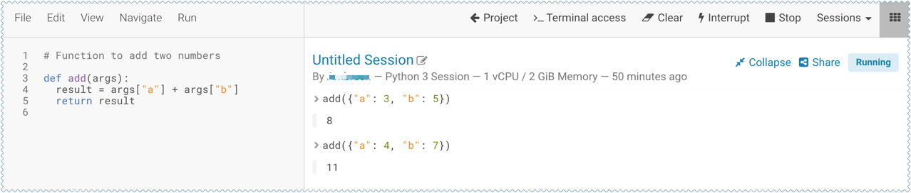

- Create a new file within the project called
add_numbers.py. This is the file where we define the function that will be called when the model is run. For example:add_numbers.py
def add(args): result = args["a"] + args["b"] return result -
Before deploying the model, test it by running the
add_numbers.pyscript, and then calling theaddfunction directly from the interactive workbench session. For example:add({"a": 3, "b": 5})

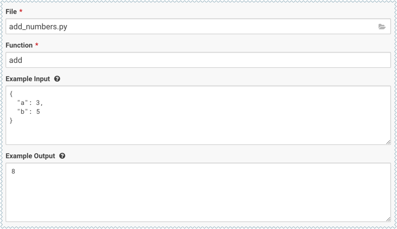

- Give the model a Name and Description.
Enter details about the model that you want to build. In this case:
- File: add_numbers.py
- Function: add
- Example Input: {"a": 3, "b": 5}
- Example Output: 8

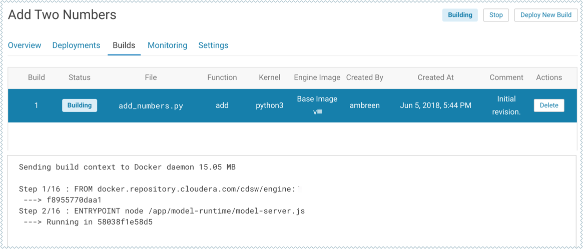

- Click Deploy Model.
Click on the model to go to its Overview page. Click Builds to track realtime progress as the model is built and deployed. This process essentially creates a Docker container where the model will live and serve requests.
