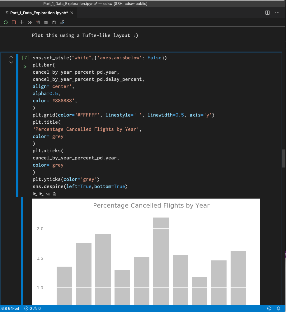

You can use VS Code with Jupyter Notebooks.
    You can work on Jupyter Notebooks within VS Code. This gives
      you all the great code completion, syntax highlighting and documentation hints that are part
      of the VS Code experience and the interactivity of a Jupyter Notebook. Any changes you make to
      the Notebook will be reflected on the CDSW / CML server and can be viewed online using Jupyter
      Notebook as a browser based editor.

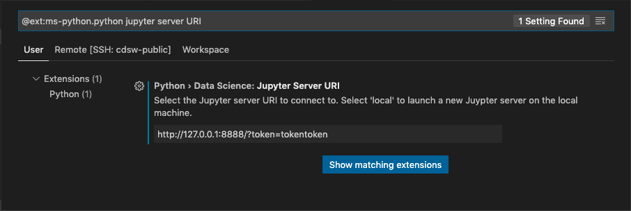

            The first setting you need to set is the Python > Data Science: Jupyter Server URI
              setting. Set this to
http://127.0.0.1:8888/?token=[some-token].

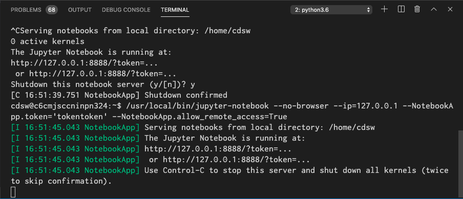

            Then you need to open a terminal to launch a Jupiter Notebook server.
You can launch it using: /usr/local/bin/jupyter-notebook —no-browser
                —ip=127.0.0.1 —NotebookApp.token=[some-token] —NotebookApp.allow_remote_access=True
            This creates a Jupyter server that any new Notebooks you launch will run in.

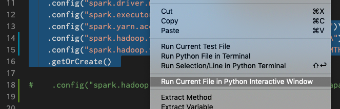

        Another feature that you can use with VS Code is running a temporary Notebook for
          executing random code snippets. Select code you want to run, right click and click
            Run Current File in Python Interactive Window.
This is less robust though and will create many Untitled*.ipynb
          files in your home directory.
