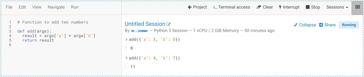

            Before deploying the model, test it by running the
add_numbers.pyscript, and then calling theaddfunction directly from the interactive workbench session. For example:add({"a": 3, "b": 5})

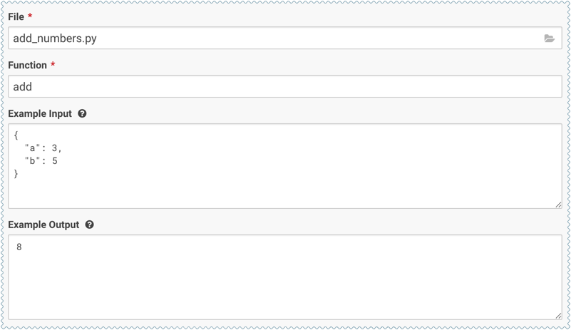

                  Enter details about the model that you want to build. In this case:
- File: add_numbers.py
 - Function: add
 - Example Input: {"a": 3, "b": 5}
 - Example Output: 8

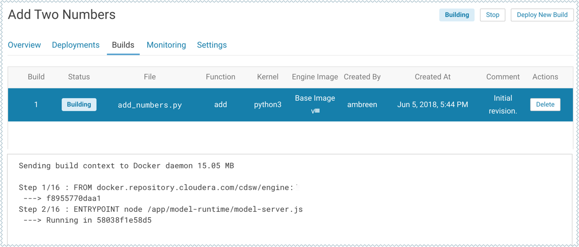

Click on the model to go to its Overview page. Click Builds to track realtime progress as the model is built and deployed. This process essentially creates a Docker container where the model will live and serve requests.
