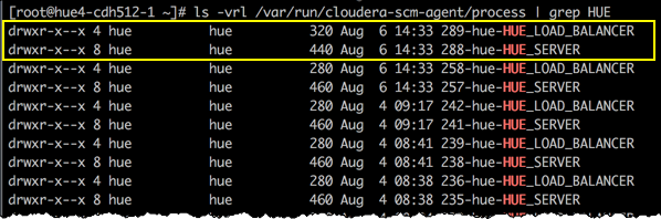

Standard stream logs
Cloudera Manager logs the start and stop of each supervised Hue process in standard
stream logs (stdout.log
, stderr.log
ls -vrl /var/run/cloudera-scm-agent/process | grep HUE

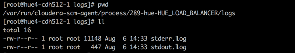

It writes to a nested
logs
directory for each running instance:
Configuration errors are written here because they prevent Hue servers and load balancers from starting properly.
