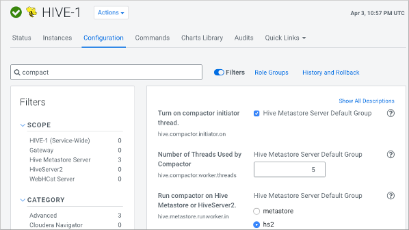

In Cloudera Manager, select the Hive metastore service: .
Search for
compact.
Check that Turn on Compactor Initiator Thread
hive.compactor.initiator.on), Number of Threads Used by
Compactor (hive.compactor.worker.threads), and Run Compactor on
Hive Metastore or HiveServer2 (hive.metastore.runworker.in) are
set to the values shown above.
Save the changes.

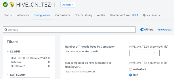

Search for
compact.
Check that the Number of Threads Used by Compactor
hive.compactor.worker.threads), and Run compactor on Hive
Metastore or HiveServer2 (hive.metastore.runworker.in) are set

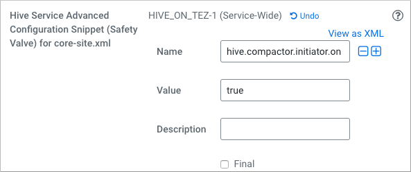

Search for advanced, and in Hive Service Advanced Configuration
Snippet (Safety Valve) for core-site.xml, click
Add the name
hive.compactor.initiator.on and value true.
Save the changes and restart the Hive on Tez and Hive (HIVE-1) metastore
services at an appropriate time.
