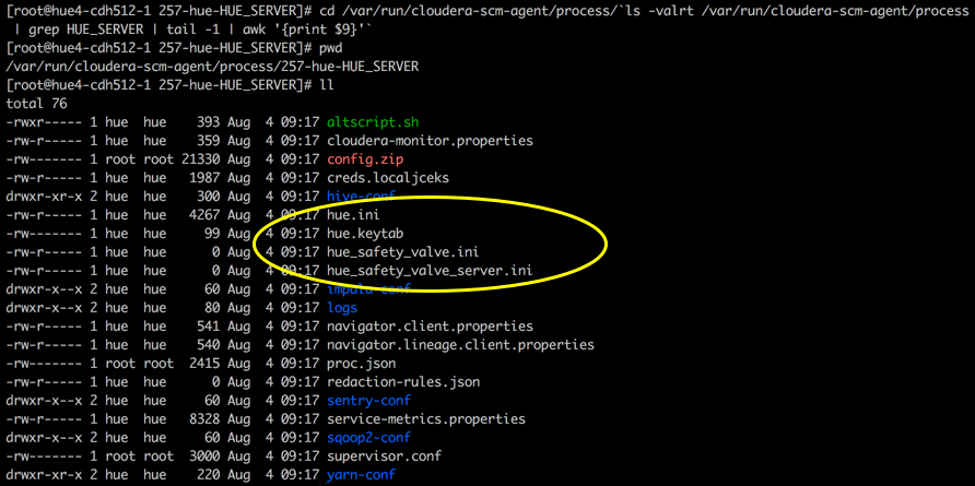

Hue roles are configured with three
.ini files
that are read in order (with the last one,
hue_safety_valve_server.ini, taking precedence):- hue.ini
- hue_safety_valve.ini
- hue_safety_valve_server.ini.
ls -ltr /var/run/cloudera-scm-agent/process/`ls -valrt /var/run/cloudera-scm-agent/process | grep HUE_SERVER | tail -1 | awk '{print $9}'`
