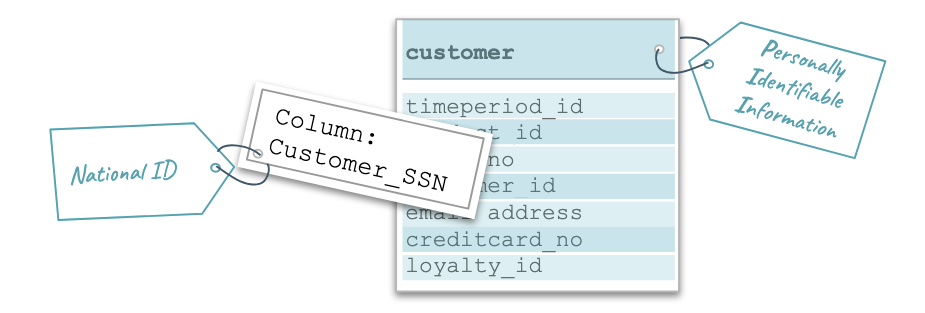

In Atlas, classifications are labels that can be assigned to entities. The flexibility of classifications makes them useful for many applications. For example, you can define classifications to describe the phases in your data prep processes and assign the classifications to specific assets to mark where they are in the process. You can define classifications to identify data to block or mask and use the classifications in access control policies in Ranger.

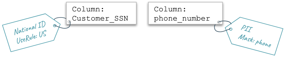

Classifications can be simple labels but they can also be defined with attributes that allow you to assign values to further describe the entity where the classification is assigned. A typical use for attributes would be to refine the meaning of a general category. Data assets identified with a classification of “PII” or Personally Identifiable Information can have classification attributes that indicate the nature of the information to drive data masking or expiration policies. Columns tagged with “PII” might be further separated into phone numbers, credit card numbers, and “other” where a Ranger policy identifies masks for the phone and credit card numbers and simply blocks columns tagged as “PII” with attribute “Other”.
