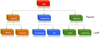

Capacity Scheduler queues can be set up in a hierarchy that reflects the database structure, resource requirements, and access restrictions required by the various organizations, groups, and users that utilize cluster resources.
The fundamental unit of scheduling in YARN is a queue. The capacity of each queue specifies the percentage of cluster resources that are available for applications submitted to the queue.
Each child queue is tied to its parent queue with the
yarn.scheduler.capacity.<queue-path>.queues
configuration property in the capacity-scheduler.xml file. The
top-level "support", "engineering", and "marketing" queues would be tied to the
"root" queue.

- Add the following values for the root queue:
Name: yarn.scheduler.capacity.root.queues Value: support,engineering,marketing Description: The top-level queues below root.
- Similarly, the children of the "support" queue would be defined as follows:
Name: yarn.scheduler.capacity.support.queues Value: training,services Description: child queues under support
- The children of the "engineering" queue would be defined as
follows:
Name: yarn.scheduler.capacity.engineering.queues Value: development,qa Description: child queues under engineering
- And the children of the "marketing" queue would be defined as follows:
Name: yarn.scheduler.capacity.marketing.queues Value: sales,advertising Description: child queues under marketing
