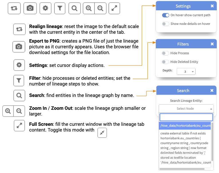

The upper right corner of the lineage picture includes the following controls:
