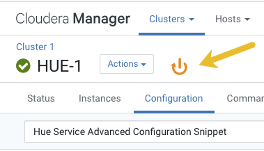

One way to limit the number of rows returned is to specify a value for thedownload_row_limitconfiguration property for the Hue Beeswax application. This property can be set in the Hue Service Advanced Configuration Snippet (Safety Valve) for hue_safety_valve.ini property in Cloudera Manager:- In Cloudera Manager, click , and enter Hue Service Advanced Configuration Snippet in the search text box.
In the text box for the Hue Service Advanced Configuration Snippet (Safety Valve) for hue_safety_valve.ini, add the following configuration information:
[beeswax] download_row_limit=number_of_rows -
Click Save Changes and click the restart icon at the top of the page to restart the Hue service:
