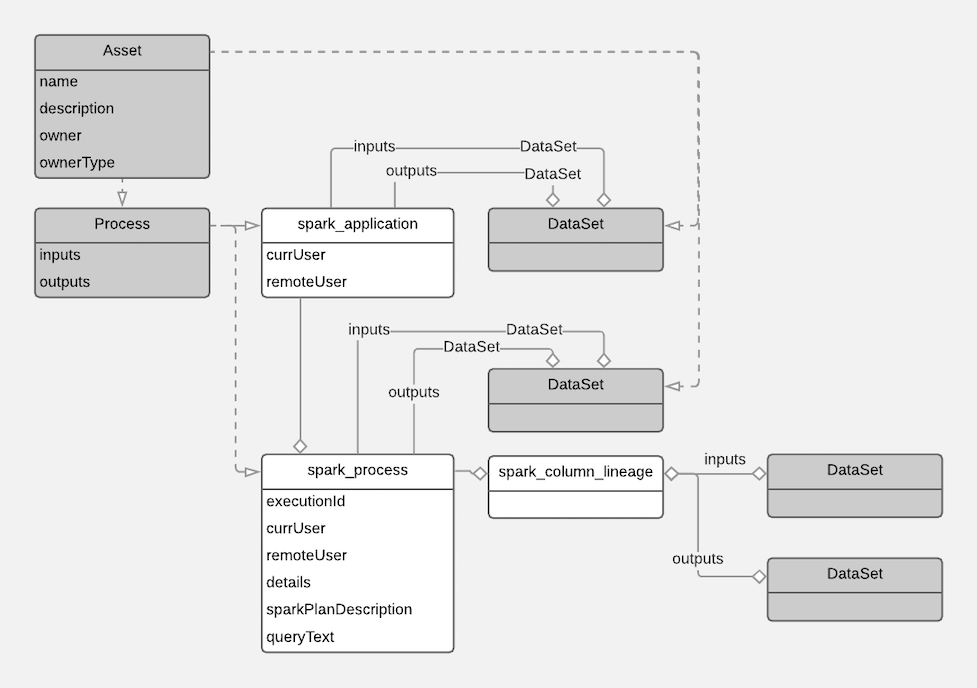

Each Spark entity in Atlas includes detailed metadata collected from Spark.
The following diagrams show a summary of the entities created in Atlas for Spark operations. The data assets that Spark operations act upon are collected through HMS. The supertypes that contribute attributes to the entity types are shaded.
The metadata collected for each entity type is as follows:

| Relationship: processes | List of Spark process entities created as part of the processing accomplished in this Spark job. |

| inputs | List of the input tables or views, including each entity’s type name and the qualified name. |
| outputs | List of the output objects, including each entity’s type name and the qualified name. |

| Relationship: inputs | List of the input tables or views, including each entity’s type name and the qualified name. |
| Relationship: outputs | List of the output objects, including each entity’s type name and the qualified name. |
| Relationship: application | The Spark application entity that describes the Spark job in which this process was created. |

| Relationship: Process | Name of the spark_process entity that
produced this lineage.
spark_process_column_lineages |
| Relationship: inputs | List of the input columns, including each entity’s type name and the qualified name. |
| Relationship: outputs | Output column, including each entity type name and the qualified name. |
