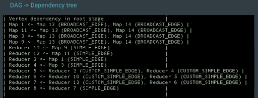

The crux of the query execution lies in the time taken by mappers and reducers and all tasks within them. When you are debugging a query to optimize its performance, you look into the vertex that took the longest time to run.
- Broadcast: sends the same data to every node
- Simple edge: sorts the data and sends it to the reducer
- Custom simple edge: sends data without sorting it

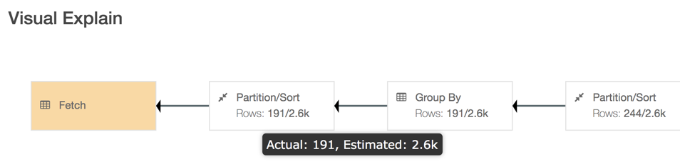

The Visual Explain plan must be read from right to left. This is the DAG of how the query tasks are getting executed. You can get additional details that were captured while executing the query by clicking the boxes in the Visual Explain plan.

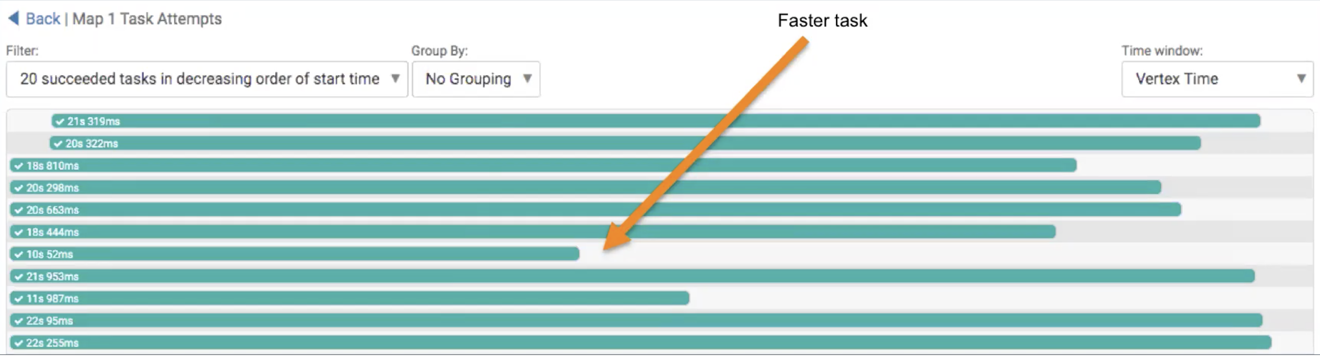

Accessing detailed logs of mapper and reducer tasks
DAS also allows you to download detailed logs of a task attempt. The log provides information about the container in which the task was running. To download the logs, click anywhere on the task attempt. On the Details pop-up, click Open log in new tab.
