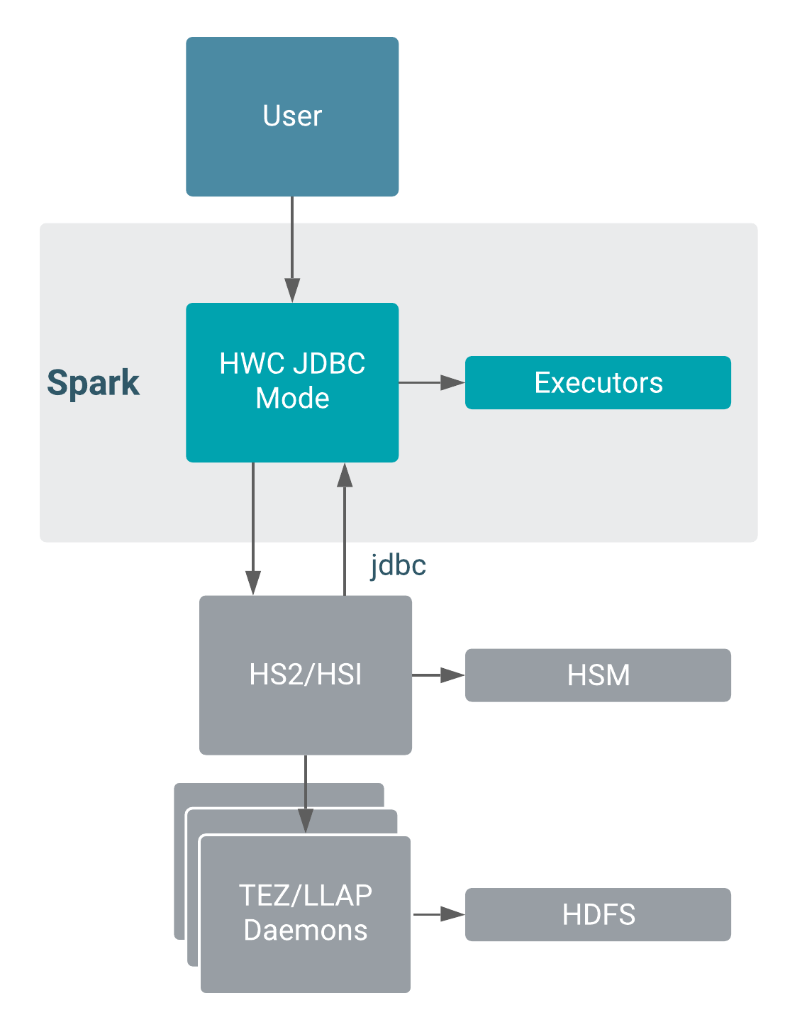

Component Interaction
JDBC mode creates only one JDBC connection to HiveServer (HS2) or HiveServer Interactive (HSI), a potential bottleneck in data transfer to Spark. The following diagram shows interaction in JDBC mode with Hive metastore (HMS), TEZ, and HDFS.
HWC does not use JDBC mode during a write. HWC writes to an intermediate location from Spark, and then executes a LOAD DATA query to write the data. Using HWC to write data is recommended for production.
