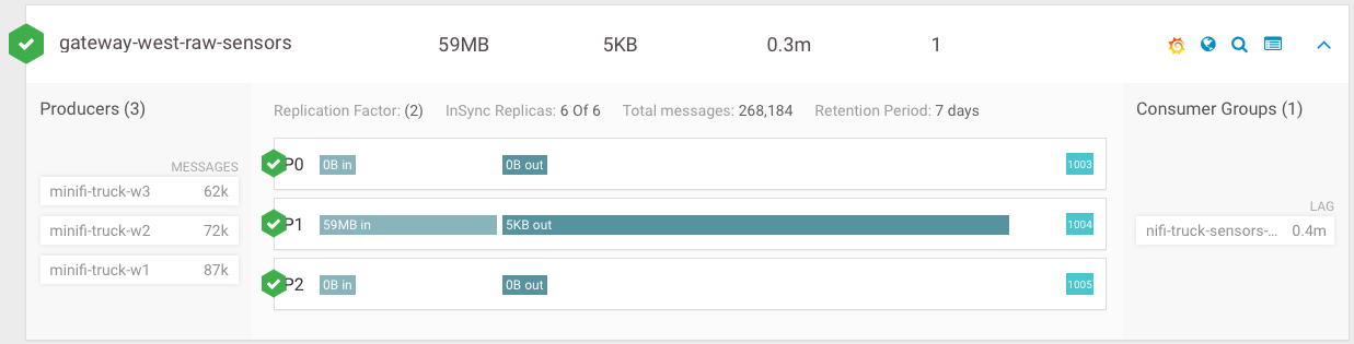

The Topic page contains a number of useful details about your Kafka Topics. This page helps you answer the following questions:
- How can I see if the replicas in this Topic are in sync?
- How do I see this Topic's retention rate?
- How can I see the replication factor for this Topic?
- How do I see the Producers and Consumers that are connected to this Topic?
- How do I find the total number of messages going into this Topic, over a specified time range?
To access this detailed Topic information:
- From the left navigation pane, click Topics.
- Identify the Topic about which you want information. You can either scroll through the list of Topics, or use the Search bar at the top left of the page.
- Click the green hexagon at the left of the Topic to view details.
