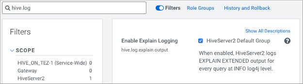

In Cloudera Manager, enable explain logging: Navigate to , search for
hive.log.explain.output, check
HiveServer2 Default Group, and click Save Changes.
