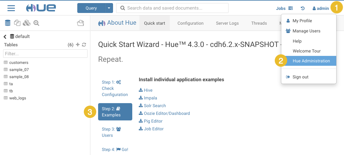

- In the Cloudera Manager Admin Console, launch Hue by selecting Clusters > Hue > Hue Web UI > Hue Load Balanced.
In the top right corner of the page, select <user_name> > Hue Administration > Step 2: Examples
- Install the sample tables for Hive and Impala by clicking the download icons

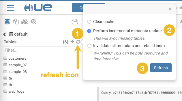

At the top of the page, click Query and then select Editor > Impala to go to the Impala SQL editor, click the refresh icon, select Perform incremental metadata update, and then click Refresh:
- In the upper left corner of the page, select the menu icon
and then select Browsers > Tables to load the Table Browser. - In the Table Browser, click Refresh on the right side of the page. This ensures that the sample tables are available to work with in Hue.

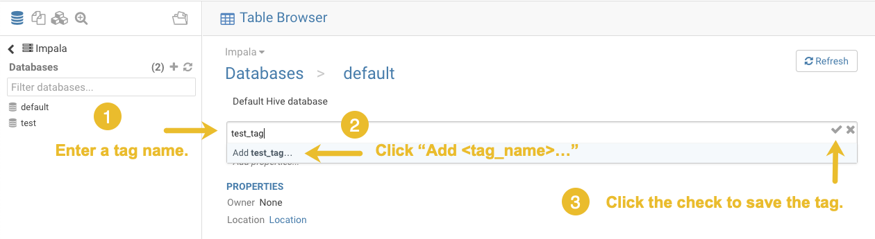

click default or some other database. This loads a detail view
of the database -
To add a database tag, click Add tags..., enter a tag name in the text box, click Add <tag_name>..., and then click the check on the right to save the tag:

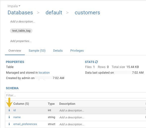

To add a table tag, click a table name, for example customers, which loads a detail view of the table where you can define a tag:
Click Add tags...:
- Enter a tag name in the text box, click Add <tag_name>..., and then click the check on the right to save the tag. This is the same process you performed for tagging the database in Step 2.

Click the information icon by a column name:
- In the dialog box that opens, click Add tags..., enter a tag name in the text box, click Add <tag_name>..., and then click the check on the right to save the tag.
