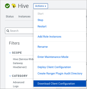

In Cloudera Manager (CM), click click Actions, and select Download Client Configuration.
Unpack
hive_on_tez-clientconfig.zip, open beeline-site.xml,
and copy the value of beeline.hs2.jdbc.url.hive_on_tez. This
value is the JDBC URL.
