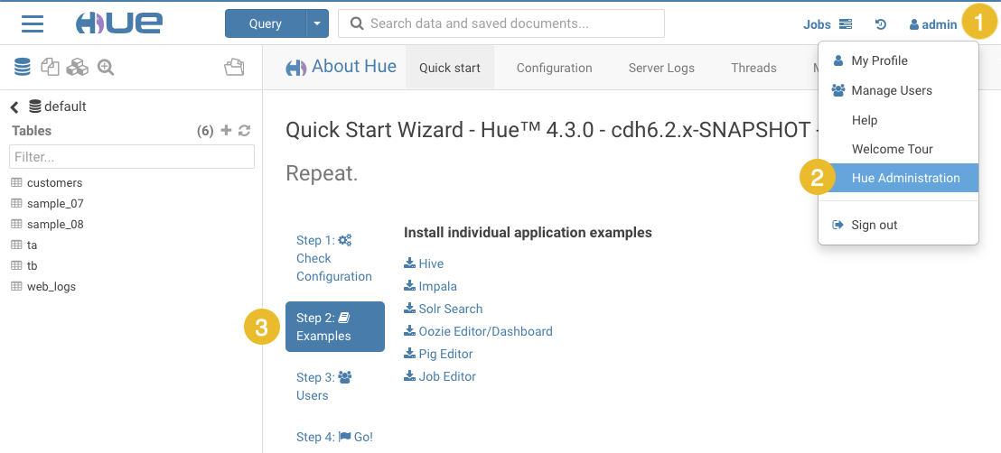

- In the Cloudera Manager Admin Console, launch Hue by selecting Clusters > Hue > Hue Web UI > Hue Load Balanced.
In the top right corner of the page, select <user_name> > Hue Administration > Step 2: Examples
- Install the sample tables for Hive and Impala by clicking the download icons

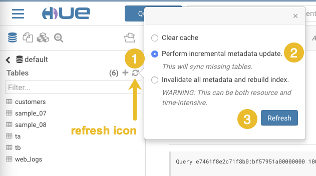

At the top of the page, click Query and then select Editor > Impala to go to the Impala SQL editor, click the refresh icon, select Perform incremental metadata update, and then click Refresh:
- In the upper left corner of the page, select the menu icon
and then select Browsers > Tables to load the Table Browser. - In the Table Browser, click Refresh on the right side of the page. This ensures that the sample tables are available to work with in Hue.

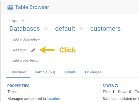

To add a table tag, click a table name, for example customers, which loads a detail view of the table where you can define a tag:
Click Add tags...:
- Enter a tag name in the text box, click Add <tag_name>..., and then click the check on the right to save the tag. This is the same process you performed for tagging the database in Step 2.

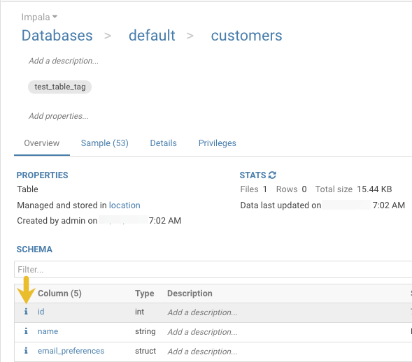

To add a field tag:
Click the information icon by a column name:
- In the dialog box that opens, click Add tags..., enter a tag name in the text box, click Add <tag_name>..., and then click the check on the right to save the tag.
