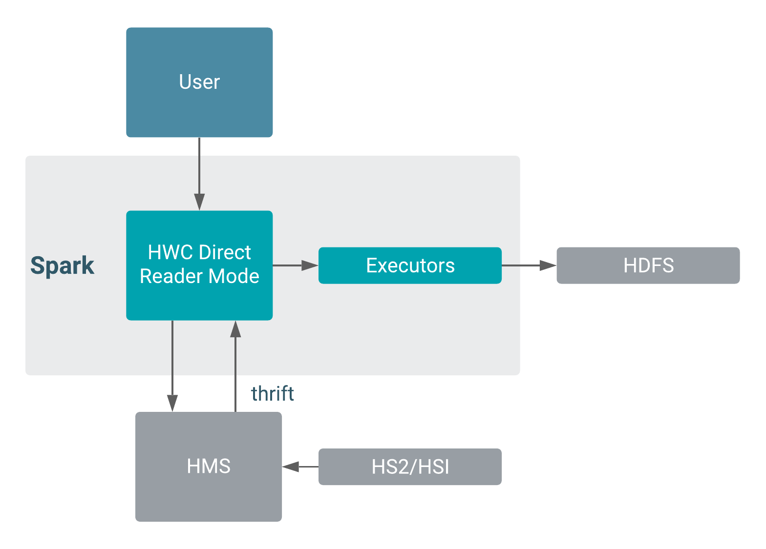

A detailed description of Spark Direct Reader mode includes how the Hive Warehouse Connector (HWC) transparently connects to Apache Hive metastore (HMS) to get transaction information, and then reads the data directly from the managed table location using the transaction snapshot. The properties you need to set, and when you need to set them, in the context of the Apache Spark session helps you successfully work in this mode.

The following diagram shows component interaction in HWC Spark Direct Reader mode.
