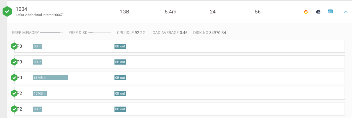

The Brokers page contains a number of useful details about your Kafka Brokers. This page helps you answer the following questions:
- On what host is my Broker located?
- Is my Broker running out of disk space?
To access detailed Broker information:
- From the left navigation pane, click Brokers.
- Identify the Broker about which you want information. You can either scroll through the list of Brokers, or use the Search bar at the top left of the page.
- Click the green hexagon at the left of the Broker to view details.

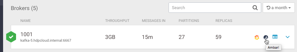

Viewing Additional Details About the Broker Host
You can view additional details about the Broker host from Ambari. To access this information:
- Click the Ambari icon on the right side of the Broker view.
