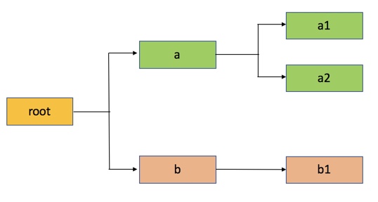

Assume that a cluster has a total of 8 nodes. The first 3 nodes (n1-n3) have node label=x, the next 3 nodes (n4-n6) have node label=y, and the final 2 nodes (n7, n8) do not have any Node Labels. Each node can run 10 containers.
The queue hierarchy is as follows:
Assume that queue “a” can access Node Labels “x” and “y”, and queue “b” can only access node label “y”. By definition, nodes without labels can be accessed by all queues.

Similarly, we can set the capacities of the child queues a1, a2, and b1:
a1 and a2: capacity(a.a1) = 40, capacity(a.a1, label=x) =30, capacity(a.a1, label=y) =50 capacity(a.a2) = 60, capacity(a.a2, label=x) =70, capacity(a.a2, label=y) =50;
b1: capacity(b.b1) = 100, capacity(b.b1, label=y) = 100

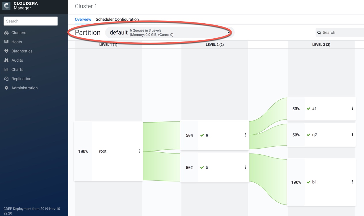

- In Cloudera Manager, select Clusters > YARN Queue Manager UI service. A graphical queue hierarchy is displayed in the Overview tab.

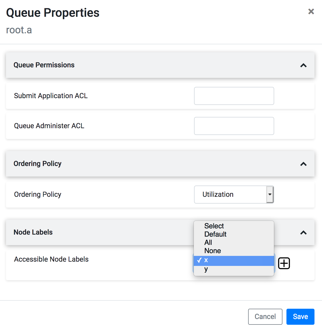

- Click on the three vertical dots on a queue and select the View/Edit Queue Properties option.
- In the Queue Properties dialog-box , select the x label from the
Accessible Node Labels drop-down box, click +, agiain select
the y label from the Accessible Node Labels drop-down boxand
click Save.
- Repeat the above steps to assign x label for a1 and a2 queues.
- Click on the three vertical dots on b queue and select the View/Edit Queue Properties option.
- In the Queue Properties dialog-box, select the y label from the Accessible Node Labels drop-down box, click +, and click Save.
- Repeat the above steps to assign y label for b1, a, a1, and a2 queue.

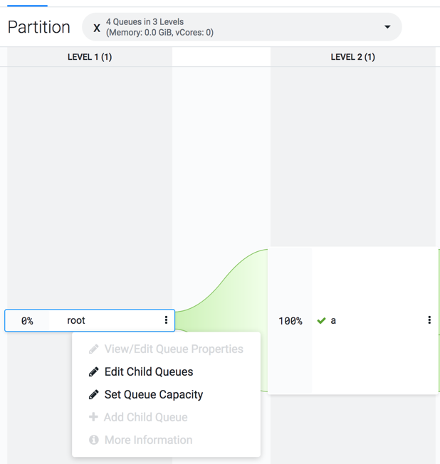

- In the Overview tab, click on the Partition drop-down box and
select label x.

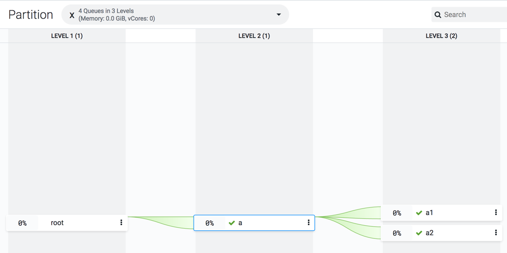

- Click on the three vertical dots on the a queue and select the Edit
Child Queues option.
- Enter the Configured Capacity of a1 to 40 and a2 to 60.
- Click on the three vertical dots on the root queue and select the Edit Child Queues option.
- Enter the Configured Capacity of a to 100 and Click Save.
- Click on the three vertical dots on the root queue and select the Set
Queue Capacity option.
