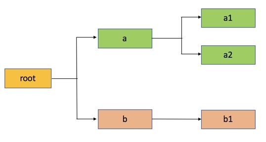

The queue hierarchy is as follows:

Similarly, you can set the capacities of the child queues a1, a2, and b1:
a1 and a2: capacity(a.a1) = 40, capacity(a.a1, label=x) =30, capacity(a.a1, label=y) =50 capacity(a.a2) = 60, capacity(a.a2, label=x) =70, capacity(a.a2, label=y) =50;
b1: capacity(b.b1) = 100, capacity(b.b1, label=y) = 100

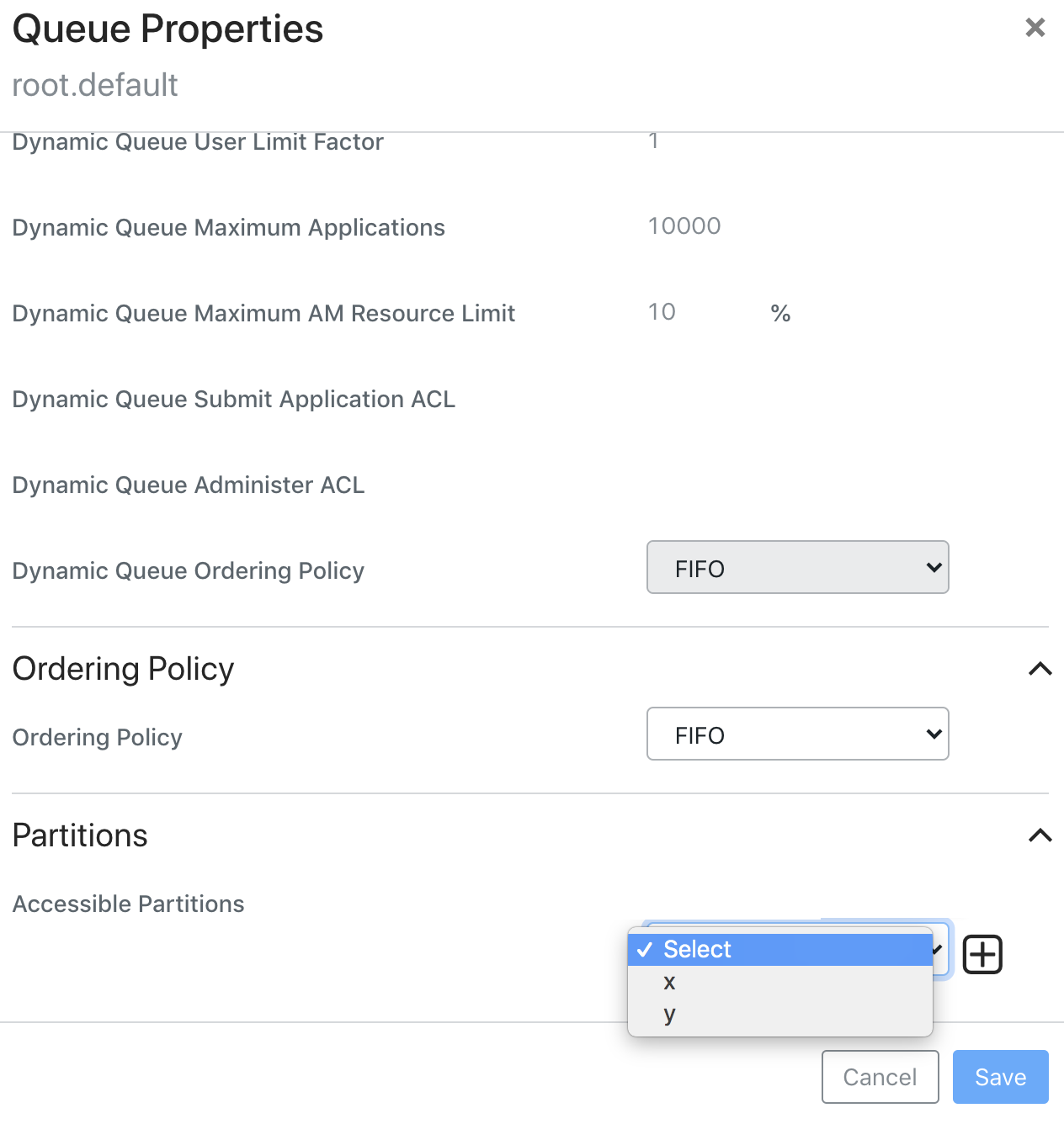

- In Cloudera Manager, select Clusters > YARN Queue Manager UI service. A graphical queue hierarchy is displayed in the Overview tab.
- Click on the three vertical dots on a queue and select the View/Edit Queue Properties option.
- In the Queue Properties dialog-box , select the x label from the
Accessible Node Labels drop-down box, click +, again select
the y label from the Accessible Node Labels drop-down boxand
click Save.
- Repeat the above steps to assign x label for a1 and a2 queues.
- Click on the three vertical dots on b queue and select the View/Edit Queue Properties option.
- In the Queue Properties dialog-box, select the y label from the Accessible Node Labels drop-down box, click +, and click Save.
- Repeat the above steps to assign y label for b1,
a, a1, and a2 queue.
