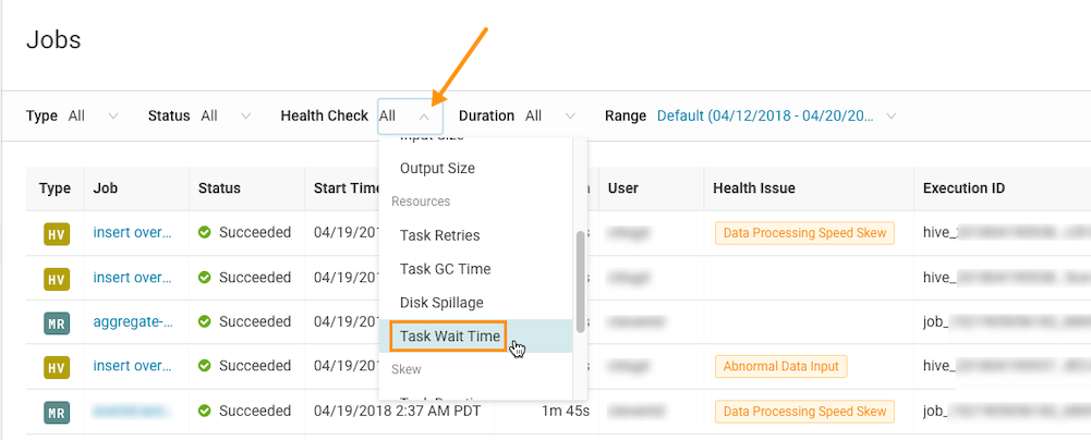

From the Health Check list in the Jobs page, select
Task Wait Time, which filters the list to display a
list of jobs with longer than average wait times before the process is
executed.

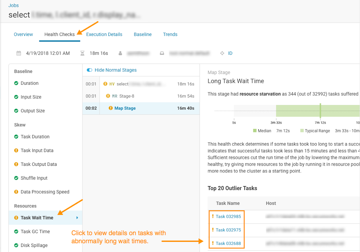

From the Health Checks panel, select the Task
Wait Time health check.
For example, as shown in the following image, the long wait time occurred in the Map Stage of the job process due to insufficient resources:

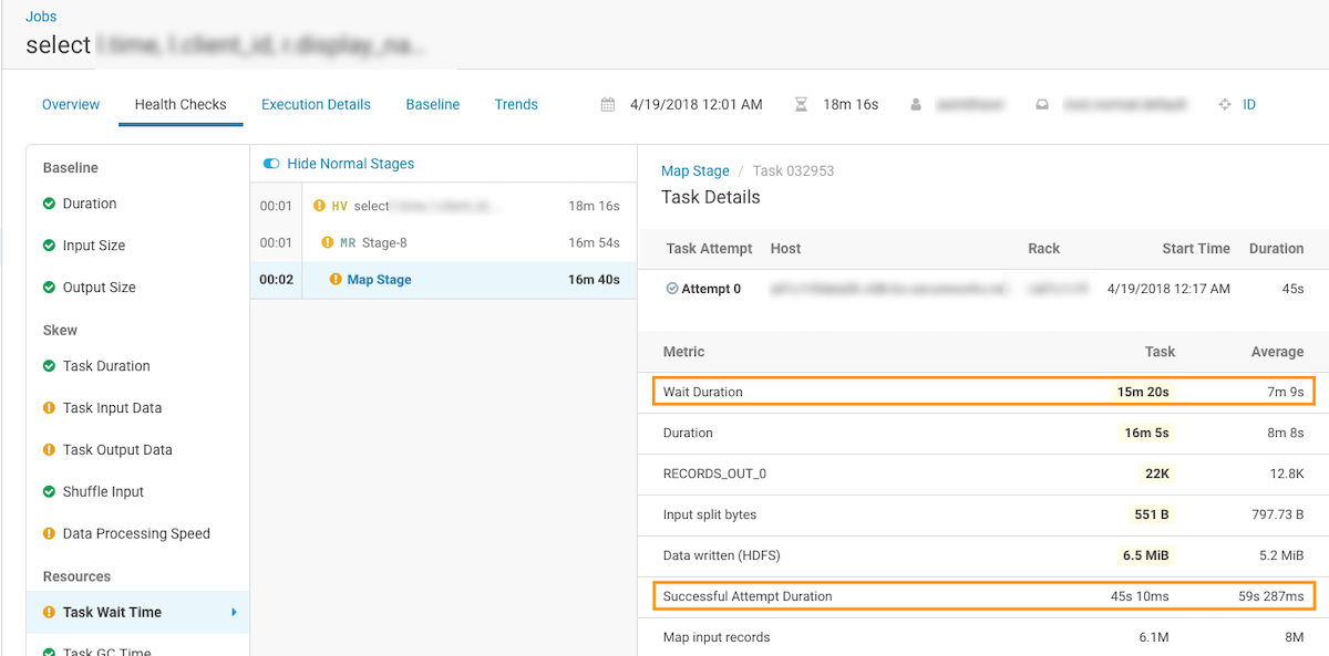

To display more information about the Map Stage tasks that are experiencing
longer than average wait times before they can execute, click one of the tasks
listed under Outlier Tasks.
In the following example, the Task Details show that the task's wait time is above average. When comparing the Wait Duration value with the Successful Attempt Duration value, the task when it does finish has a significantly better than average time. This indicates that insufficient resources are allocated for this job.
