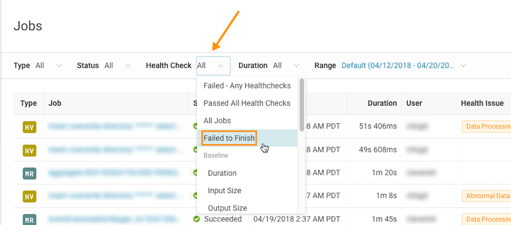

From the Health Check list, select Failed to
Finish, which filters the list to display a list of jobs that
did not complete.

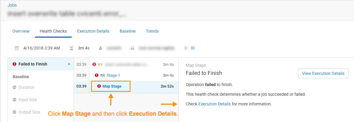

From the Health Checks panel, select the
Failed to Finish health check.

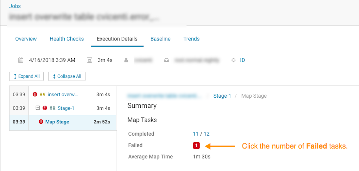

For example, as shown in the following image, the failure occurred in the Map Stage of the job process:
- To display more information about the Map Stage process, click Map Stage and then from the Map Stage panel, click Execution Details.
To display all the failed tasks, in the Summary panel,
click the Failed value:

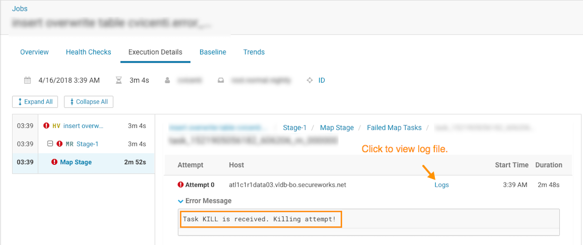

To display the reason for a task's failure, select and expand its error
message.
For example, as shown in the following image, the task was not completed because it was stopped. To understand what triggered the
Task KILL is received. Killing attempt!error message and to further troubleshoot the root cause, open the associated log file by clicking Logs.
