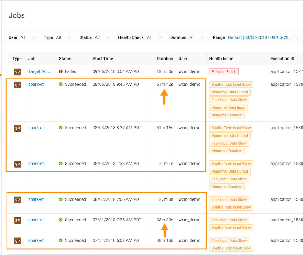

Examine the list of jobs that have executed during the selected time period:
For example, as shown in the following image, the last three runs of the
spark-etl job have taken significantly longer to complete
than usual. Where, on August 2, the duration was 27 minutes, but on August 3,
the duration almost doubled to 51 minutes:

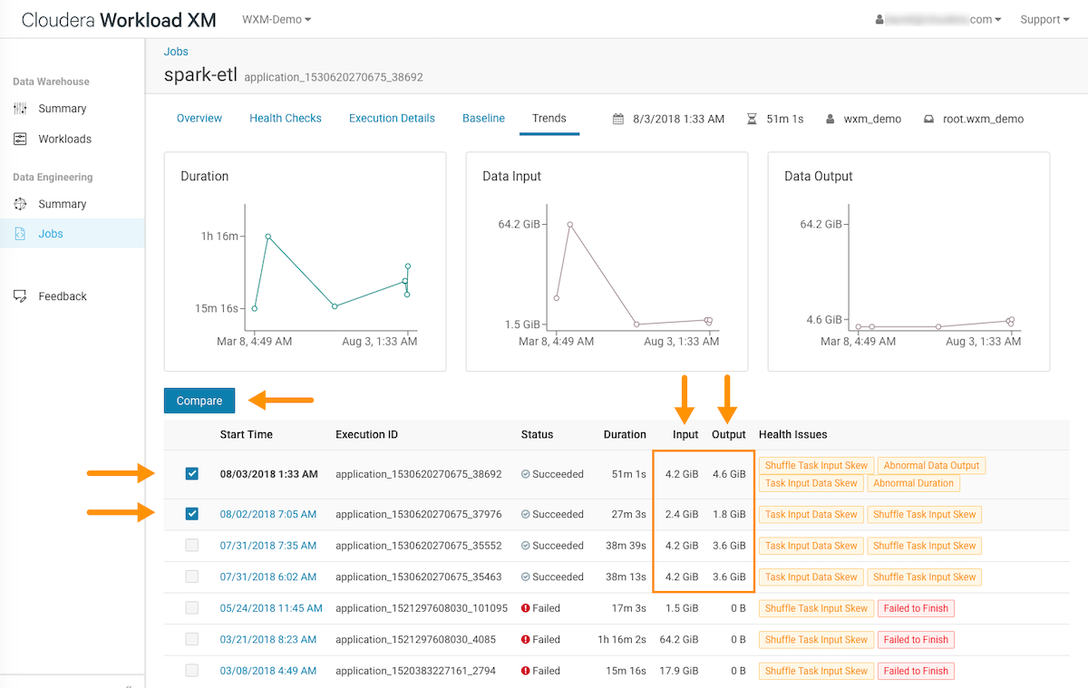

In the following example, notice how the amount of data changes in the Input
and Output columns. Where, on August 2, the job processed 2.4 GB of data, but on
August 3, the job processed 4.2 GB, which is almost twice as much data. The Job
Comparison tool will enable you to examine both runs to determine why the amount
of data changed:
To compare two job runs, select the check boxes adjacent to the job runs you
require, in this case the runs for August 2 and August 3 are selected, and then
click Compare.
The Job Comparison page opens displaying more details about each job.

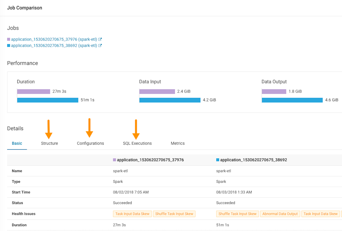

For this example's comparison, the tabs that contain more information about
the job runs are the Structure,
Configurations, and the SQL
Executions tabs:

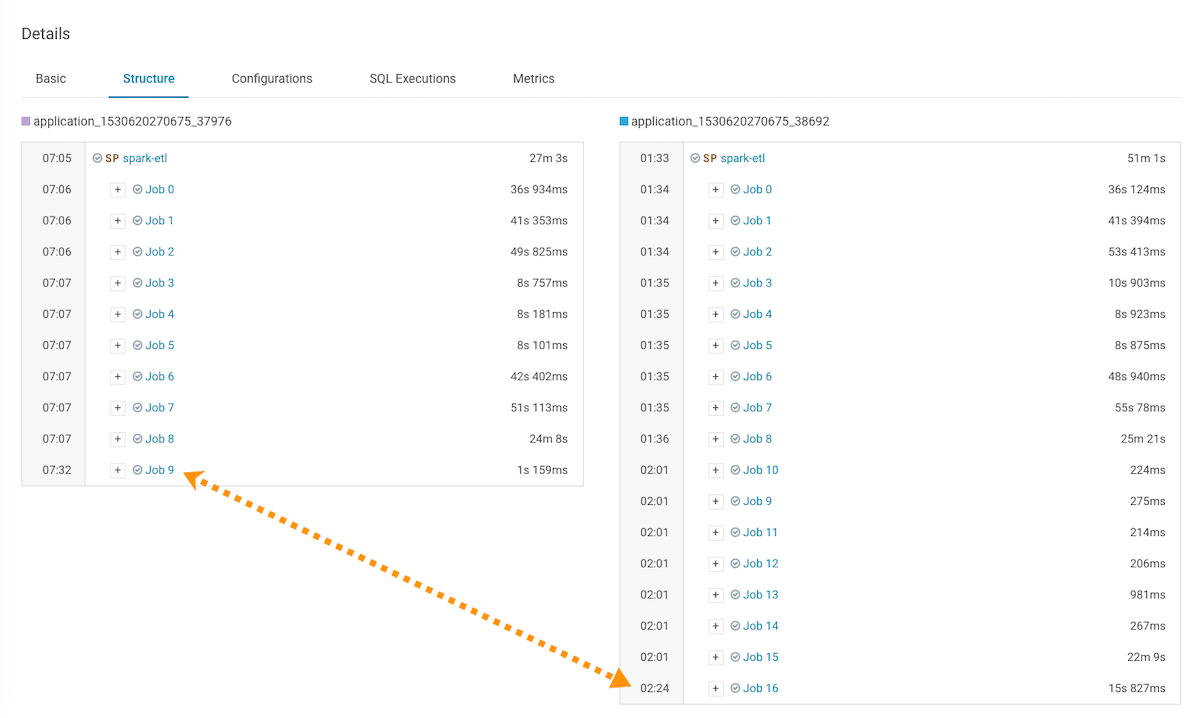

Display the sub-jobs executed for both of your selected job runs by selecting
the Structure tab.
For example, as shown in the following image, the job that took 27 minutes
only executed 9 sub-jobs and the job that took 51 minutes, almost twice as much
time, executed 16 sub-jobs, almost twice as many. Clicking any of the listed
sub-jobs displays more details.

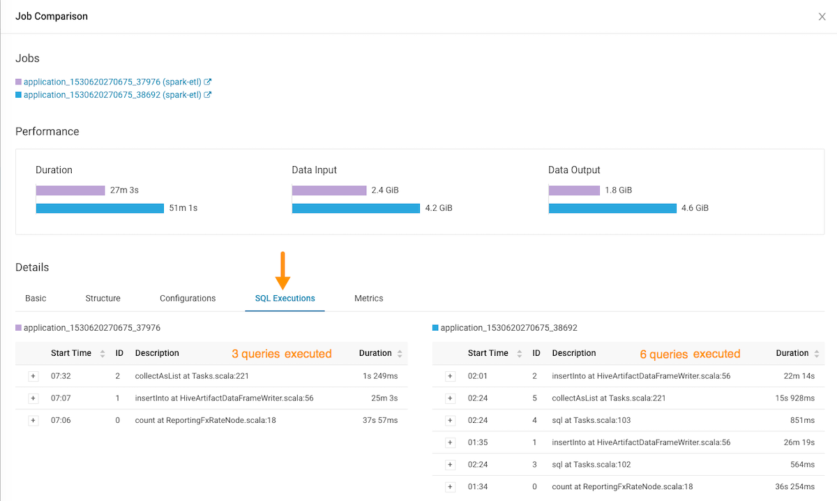

Display the number of SQL executions by selecting the SQL
Executions tab.
For our example, as shown by the following image, twice as many Spark queries
executed for the job that took the longest duration.
The analysis from the Job Comparison tells us that either
the Spark SQL code was changed by the Job Developer or that the data on which the code
ran triggered more of the Spark queries in the job. The Workload XM Job
Comparison tool helped narrow the number of causes that produced the anomaly. For our
example, the change in job duration appears to be expected so no further troubleshooting
is required.
