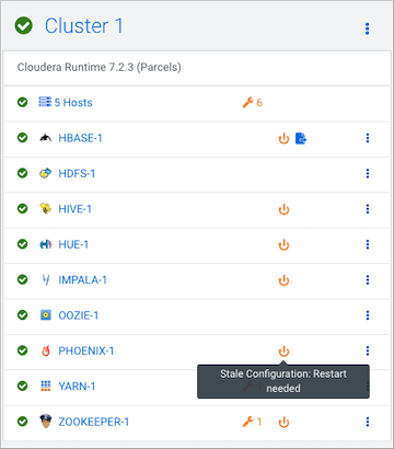

Back in the Cloudera Manager Home page, select the
Status tab.
Notice that the Stale Configuration: Restart needed indicator is displayed for both the HBase and Phoenix services.
Restart the HBase and Phoenix services by doing one of the following:
- Click the HBase or Phoenix vertical ellipses icon and then select Restart.
- Click the HBase or Phoenix Stale Configuration indicator.
- In the Stale Configurations page, click Restart Stale Services.
- In the Restart Stale Services page, select the Re-deploy client configuration check box and click Restart Now.
- Monitor the restart progress until the All requested services successfully restarted message appears and then click Finish.
