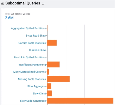

- The Suboptimal chart widget, which displays the distribution of jobs
and the jobs and queries that failed. This chart widget enables you to visually see at a
glance what issues are currently impacting your jobs or queries and how they are
executing on your cluster:
Location: This chart widget is found on the engine's page after selecting the workload cluster for analysis and then from the navigation side-bar, selecting an engine.

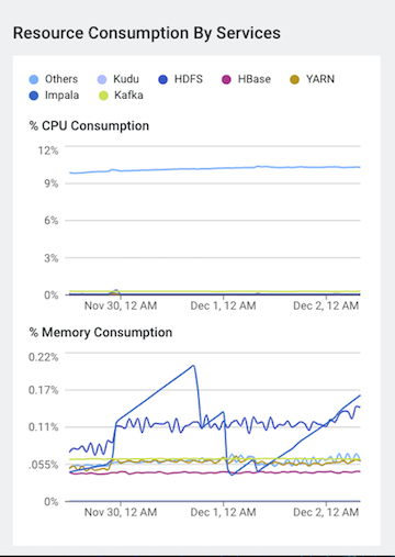

- The Resource Consumption By Services chart widget displays
the CPU and memory consumption for each service across the time range you selected.
Hover your mouse over the time line, to display the amount of CPU or memory, as a
percentage, that is consumed by each of the cluster's services.

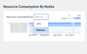

- The Resource Consumption By Nodes chart widget displays the
CPU and memory consumption for each node in the cluster. Hover your mouse over the
time line, to display the amount of CPU or memory, as a percentage, that is consumed
by each node and its services.

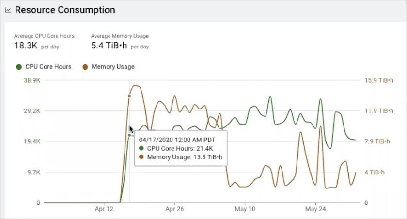

- The Resource Consumption chart widget, displays the
concurrent use of CPU and memory consumption for a workload across the time line you
selected.

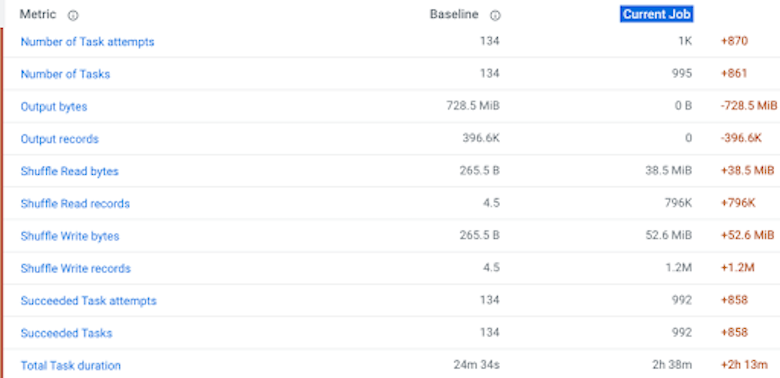

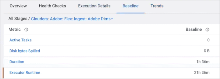

Workload XM enables you to identify and address abnormal or degraded performance problems by establishing baselines from health issues that also enable a performance comparison of your workloads. The Workload XM baseline metrics measure the current performance of a job against the average performance of previous runs. They use performance data from 30 of the most recent runs of a job and require a minimum of three runs. The baseline comparisons start with the fourth run of a job.
- This image shows a few of the performance metrics listed in the Baseline tab:
- This image shows the comparison between the baseline performance metrics and the current
job run:

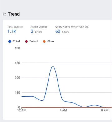

- The Trends time-series chart widget, displays more detailed metrics
about the processed jobs and queries and enables you to view historical trends for
analysis when you select a predefined or custom time period from the
Range filter list.
Location: This chart widget is found on the engine's page, which is accessed by selecting the workload cluster for analysis and then from the navigation side-bar, selecting the engine of interest.
