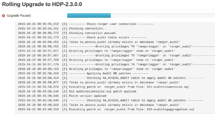

​4.4. Problem: Ranger Admin UI does not function after upgrading HDP from 2.2 to 2.3
Ranger upgrade patches may fail to complete, during an upgrade of the HDP Stack from 2.2 to 2.3, causing the Ranger Admin UI to not funtion correctly after the upgrade.
​4.4.1. Solution: Run the DB and Java patch scripts manually, then Retry Upgrading Ranger.
  1. On the Rolling Upgrade dialog, stdout tab, review the Ambari log files to determine which patch caused a timeout. For example, the following image shows a timeout during SQL patch execution.
    Based on your review, determine whether DB or Java patch scripts (or both) have failed to complete.
  2. Log in to the Ranger Admin host.
  3. On the Ranger Admin host, in /usr/hdp/2.3.x.y-z/ranger-admin/, run the following commmands:
    For DB patch failure:
    python db_setup.py
    For JAVA patch failure:
    python db_setup.py -javapatch
  4. Confirm that all patches complete successfully.
  5. In Ambari Web, in the Rolling Upgrade dialog at the Ranger Paused step, click Retry.
