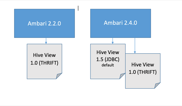

With the release of Apache Ambari 2.4.0, two Hive views install as part of your Hortonworks Data Platform distribution:
Hive View 1.0 - which works with Thift Java API
Hive View 1.5 - which works with the JDBC client
Previously, HDP only installed Hive View 1.0. Hive View 1.5 is now the default when you create a new view.
You can run both views simultaneously, use only one of the views, or upgrade your data from the older view to the newer view. Hortonworks recommends, for enhanced security and because of the future deprecation of Hive View 1.0, that you upgrade and migrate your data from the Hive View 1.0 to the Hive View 1.5.
