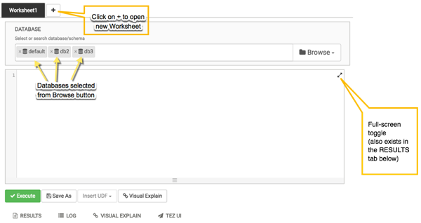

  • The Query Editor field and an active RESULTS tab can be toggled between compact and full-screen mode. The screenshot below shows the compact mode. Full-screen mode enlarges the query editor field, which can help you author large, complex SQL queries or browse large query results.
  • Use multiple Worksheet tabs to work on and analyze queries in parallel.

Use the Browse button in the Query Editor to find and select databases. After you select databases and make them active in the view, they appear in the database and table pane.

  • Enter queries in the blank field. To run a specific query, highlight it, and click Execute. All queries contained in a Worksheet tab execute sequentially, and they run in the same session.

  • Click on the + symbol to open a new worksheet tab. Queries executed from the new worksheet tab will execute in a different session. Queries from different worksheets can execute in parallel.

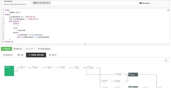

Hive View 2.0 includes a simple, graphical visualization of the Hive execution plan that focuses on key information that can help you spot expensive operations in your query.
Clicking he Visual Explain tab launches a visual explain plan.
Figure 6.5. SQL in Query Editor with Resulting Visual Explan Plan
The visual explain plan illustrates the execution of the query, regardless of whether you run the query or not. So you can use the Visual Explain feature truly as a planning tool.

The workflow sequence of the visual explain plan is plotted beginning on the right side and proceeding to the left.
The nodes of the explain plan contain kernels of information that help you forecast or troubleshoot execution problems. Key information of the plan includes:
  • Execution “cost”: The number of processed rows for each node of the visual explain plan is displayed, which gauges the resource demands of the various runtime processes of an executing query.
  • Labeling of runtime processes for easy comparison: Each node is identified by type of operation or process. For example, you can see which nodes represent “cheap” Map Join activity and compare them to “expensive” Partition or Sort operations.

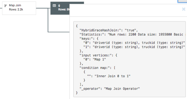

Click on a node to view detailed information about SQL operators:
Figure 6.6. Details of a Map Join Node
