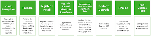

This topic describes available upgrade options, their prerequisites, and the overall process. You are strongly encouraged to read completely through this entire document before starting the upgrade process, to that you understand the interdependencies and order of the steps. It is highly recommended you validate these steps in a test environment to adjust and account for any special configurations for your cluster.
The high-level process for performing an HDP upgrade is as follows:
Ambari will guide you through the steps required to upgrade HDP. Make sure Ambari and the cluster are healthy, operating normally, and all service checks are passing.
