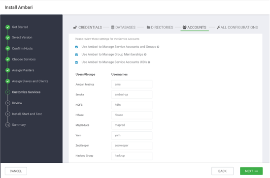

Accounts
The service account users and groups are also configurable from the Accounts tab. These are the operating system accounts the service components will run as. If these users do not exist on your hosts, Ambari will automatically create the users and groups locally on the hosts. If these users already exist, Ambari will use those accounts.
Depending on how your environment is configured, you might not allow groupmod or usermod operations. If this is the case, there are multiple options to choose how Ambari should handle user creation and modification:
Use Ambari to Manage Service Accounts and Groups
Ambari will create the service accounts and groups that are required for each service if they do not exist in /etc/password, and in /etc/group of the Ambari Managed hosts.
Use Ambari to Manage Group Memberships
Ambari will add or remove the service accounts from groups.
Use Ambari to Manage Service Accounts UID's
Ambari will be able to change the UID’s of all service accounts.

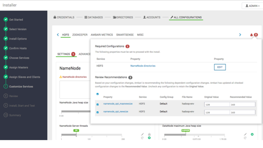

All Configurations
Here you have an opportunity to review and revise the remaining configurations for your services. Browse through each configuration tab. Hovering your cursor over each of the properties, displays a brief description of what the property does. The number of service tabs shown here depends on the services you decided to install in your cluster. Any service with configuration issues that require attention will show up in the bell icon with the number properties that need attention.
The bell popover contains configurations that require your attention, configurations that are highly recommended to be reviewed and changed, and configurations that will be automatically changed based on Ambari’s recommendations unless you choose to opt out of those changes. Required Configuration must be addressed in order to proceed on to the next step in the Wizard. Carefully review the required and recommended settings and address issues before proceeding
