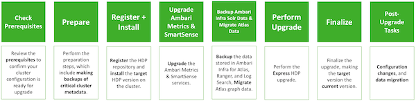

The high-level process for performing an HDP upgrade is as follows:
Ambari will guide you through the steps required to upgrade HDP. Make sure Ambari and the cluster are healthy, operating normally, and all service checks are passing.
