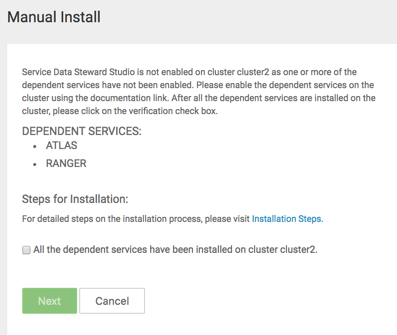

    A check runs to determine what configuration is required on the cluster for the service you selected. For example, a required service such as Apache Ranger might be installed on the clusters but not enabled in Apache Ambari.
    The Manual Install page displays, indicating what you need to configure on the cluster to make the cluster usable by the service.
  4. Perform the actions stated on the Manual Install page.
    The required actions often involve enabling a service from Ambari. For example:
    You should complete the required actions before proceeding to the next step.
  5. Click All the dependent services have been installed..., and then click Next.
    Another configuration check is run and if all requirements are met, a verification message displays. If the check fails, a message displays identifying the configuration tasks still to be completed.

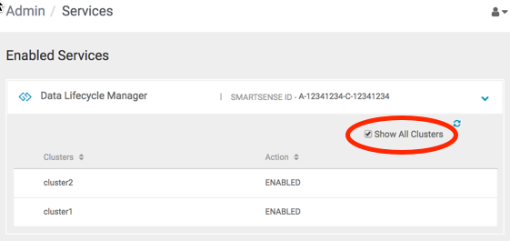

  6. Click the name of the service for which you enabled the cluster, and then enable Show All Clusters.
    The new cluster displays in the list on the Clusters page:
