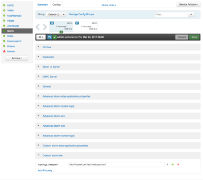

In Ambari, set up Storm to run with Kerberos and run worker jobs as the submitting user:

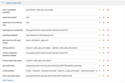

Add the following properties to custom storm-site:
topology.auto-credentials=['org.apache.storm.security.auth.kerberos.AutoTGT'] nimbus.credential.renewers.classes=['org.apache.storm.security.auth.kerberos.AutoTGT'] supervisor.run.worker.as.user=true
In the Storm config section in Ambari, choose Add Property under custom storm-site:
In the dialog window, choose the bulk property add mode toggle button and add the following values:

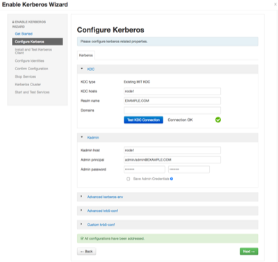

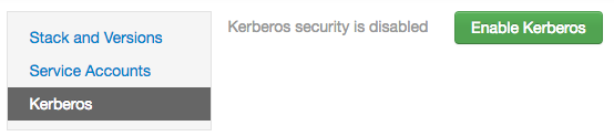

Kerberize the cluster via Ambari.
More detailed documentation can be found in Enabling Kerberos Security in the [HDP Security] guide.
For this exercise, choose existing MIT KDC (this is what you set up and installed in the previous steps.)
Set up Kerberos configuration. Realm is EXAMPLE.COM. The admin principal will end up as admin/admin@EXAMPLE.COM when testing the KDC. Use the password you entered during the step to add the admin principal.
Click through to Start and Test Services.

When you’re finished, the custom storm-site should look similar to the following:
