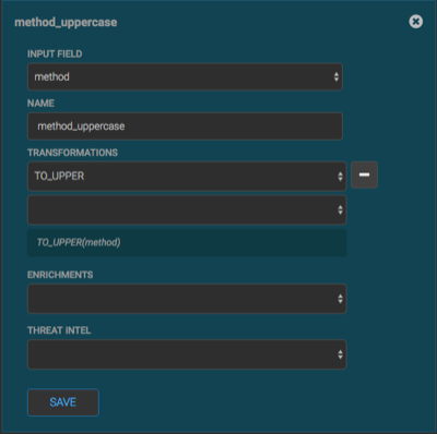

  5. In the dialog box, enter the name of the new field in the NAME field, choose an input field from the INPUT FIELD box, and choose your transformation from the TRANSFORMATIONS field or enrichment from the ENRICHMENTS field.
    For example, to create a new field showing the lower case version of the method field, do the following:
    • Enter method-uppercase in the NAME field.
    • Choose method from the INPUT FIELD.
    • Choose TO_UPPER in the TRANSFORMATIONS field.
      Your new schema information panel should look like this:
      Figure 3.14. Populated New Schema Information Panel
  6. Click SAVE to save your changes.
