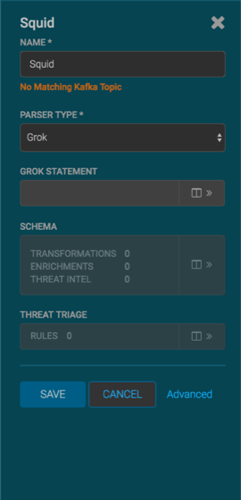

  1. In the Management module, click (edit button) for your sensor.
    The Management module displays the schema panel.
    Figure 3.1. Squid Schema Panel
  2. In the Schema box, click (expand window button).
    The Management module displays the Schema panel and populates it with message, field, and value information.
    The Sample field, at the top of the panel, displays a parsed version of a sample message from the sensor. The Management module will test your transformations against this parsed message.
    You can use the right and left arrow buttons in the Sample field to view the parsed version of each sample message available from the sensor.

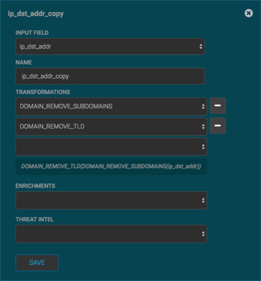

  3. To add a new transformation, either click the next to a field or click the (plus sign) at the bottom of the Schema panel.
    The module displays a new dialog box for your transformations.
    Figure 3.2. New Schema Information Panel
  4. Choose the field you want to transform from the INPUT FIELD box, enter the name of the new field in the NAME field, and then choose a function with the appropriate parameters in the TRANSFORMATIONS box. You can apply more than transformation to the input field.
    Figure 3.3. Populated Schema Information Panel
  5. Click SAVE to save your additions.
    The Management module populates the Transforms field with the number of transformations applied to the sensor.
