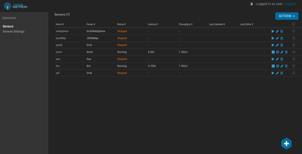

Starting and Stopping a Sensor
After you install a sensor, you can start or stop it using the Management Module.
To start or stop a sensor, select the sensor in the main window, then click
(start button) to start the sensor or
(stop button) to stop the sensor in
(tool bar) on the right side of the window.
Starting or stopping the sensor might take a few minutes. When the operation completes successfully, you should see the Status for the sensor change to the Running or Stopped.
