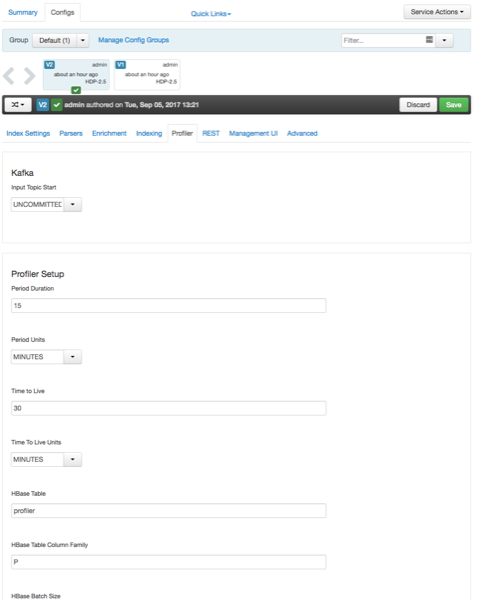

To configure the Profiler, complete the following steps:
Display the Ambari user interface and click the Services tab.
Click Metron in the list of services, then click the Configs tab.
Click the Profiler tab.
Ambari displays a list of Profiler properties that you can use to configure Profiler.
Use these properties to configure the Profiler, then click the Save button near the top of the window.
The following table provides a list of the configurable properties and descriptions.

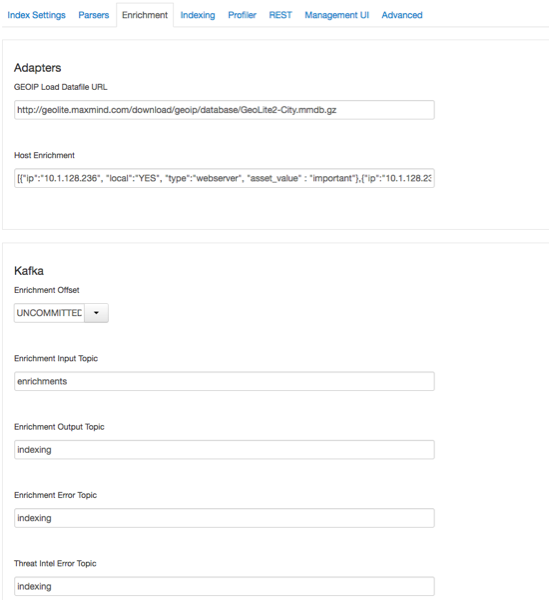

![]() | Note |
The profiler input topic is bound to the enrichment output topic. If that enrichment output topic is changed, then the profiler will restart as well as the enrichment topology. |
