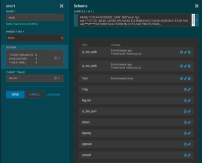

In the Schema box, click
(expand window button).The Management module displays a second panel and populates the panel with message, field, and value information.
The Sample field, at the top of the panel, displays a parsed version of a sample message from the sensor. The Management module will test your transformations against these parsed messages.
You can use the right and left arrow buttons in the Sample field to view the parsed version of each sample message available from the sensor.

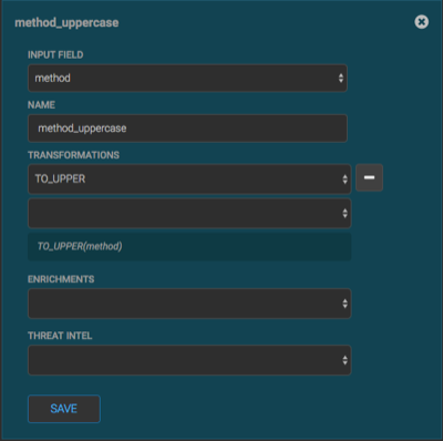

You can apply transformations to an existing field or create a new field. Click the
(edit icon) next to a field to apply transformations to that field.
Or click
(plus sign) at the bottom of the Schema panel to create new
fields.Typically users store transformations in a new field rather than overriding existing fields.
For both options, the Management module expands the panel with a dialog box containing fields in which you can enter field information.
In the dialog box, enter the name of the new field in the NAME field, choose an input field from the INPUT FIELD box, and choose your transformation from the TRANSFORMATIONS field or enrichment from the ENRICHMENTS field.
For example, to create a new field showing the lower case version of the method field, do the following:
Enter method-uppercase in the NAME field.
Choose
methodfrom the INPUT FIELD.Choose
TO_UPPERin the TRANSFORMATIONS field.Your new schema information panel should look like this:
Click SAVE to save your changes.
