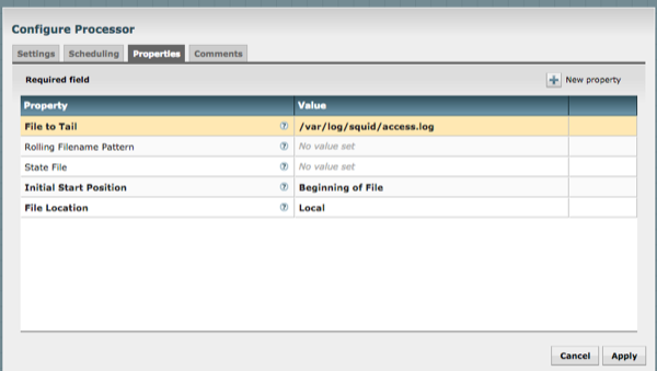

Right-click the processor icon and select Configure to display the Configure Processor dialog box.
In the Settings tab, change the name to
Ingest $DATASOURCE Events.In the Properties tab, configure the following:

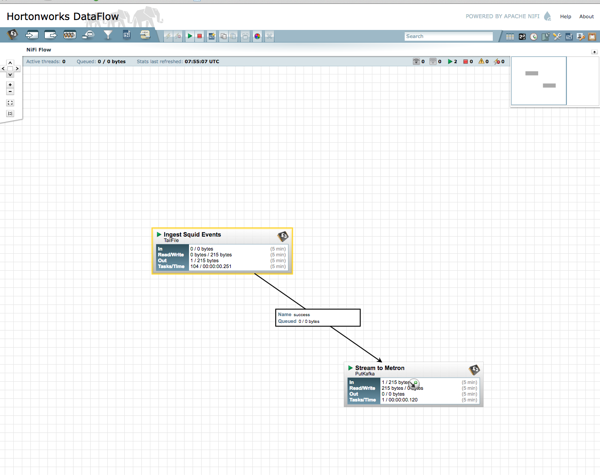

Create a connection by dragging the arrow from the Ingest $DATAPROCESSOR Events processor to the Stream to Metron processor.
Press the Shift key and draw a box around both parsers to select the entire flow; then click the play button (green arrow).
You should see all of the processor icons turn into green arrows:
Generate some data using the new data processor client.
You should see metrics on the processor of data being pushed into Metron.
Look at the Storm UI for the parser topology and you should see tuples coming in.
After about five minutes, you should see a new Elastic Search index called $DATAPROCESSOR_index* in the Elastic Admin UI.
