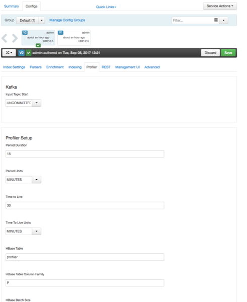

Click Metron in the list of services, then click the
Configs tab.
Click the Profiler tab.
Ambari displays a list of Profiler properties that you can use to configure
Profiler.
Profiler Properties in Ambari
Use these properties to configure the Profiler, then click the Save button near
the top of the window.

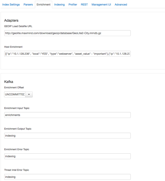

The profiler input topic is bound to the enrichment output topic. If that
enrichment output topic is changed, then the profiler will restart as well as the
enrichment topology.
