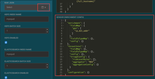

The Management Module displays the Squid sensor panel. - Click the Advanced button.
Click
(expand window button) next to the RAW
JSON field.
Replace the JSON information in the SENSOR ENRICHMENT CONFIG
section with the following JSON information:
{ "enrichment": { "fieldMap": { "geo": [ "ip_dst_addr" ], "stellar": { "config": [ "domain_without_tld := DOMAIN_REMOVE_TLD(domain_without_subdomains)", "is_potential_typosquat := BLOOM_EXISTS(OBJECT_GET('/tmp/reference/alexa10k_filter.ser'), domain_without_tld)", "domain_without_tld := null" ] } }, "fieldToTypeMap": {}, "config": {} }, "threatIntel": { "fieldMap": { "stellar": { "config": [ "is_alert := (exists(is_alert) && is_alert) || is_potential_typosquat" ] } }, "fieldToTypeMap": {}, "config": {}, "triageConfig": { "riskLevelRules": [ { "name": "Alexa 10k Typosquat Bloom", "comment": "Inspect a bloom filter with potentially typosquatted domains from the top Alexa 10k", "rule": "is_potential_typosquat != null && is_potential_typosquat", "score": 50, "reason": "FORMAT('%s is a potential typosquatted domain from the top 10k domains from alexa', domain_without_subdomains)" } ], "aggregator": "MAX", "aggregationConfig": {} } }, "configuration": {} } - Click SAVE below the JSON information.
- Click SAVE at the bottom of the Squid sensor configuration panel.

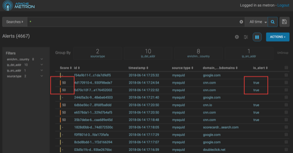

Enter
cnn.comornsp.comin the browser connected to the HCP proxy. -
Display the Alerts UI.
In the Score column, you will see events with non-zero scores and the is_alert field set to true.

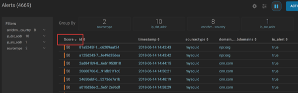

Click the Score header to sort the events ascending by
Score.
Click again to sort descending by Score. A downward arrow appears next to the Score header when sorted descending by Score.

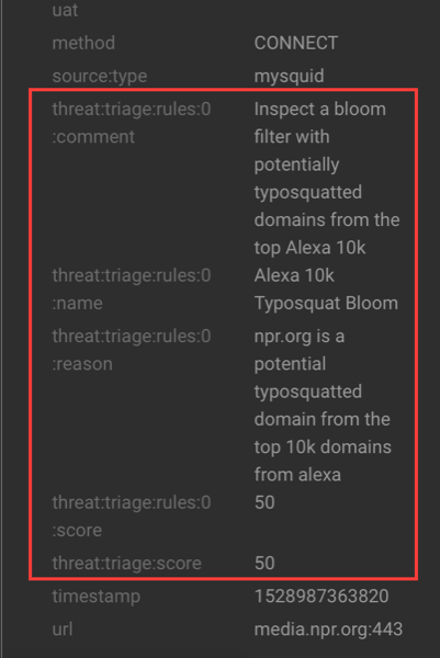

Click between the columns of one of the Scored alerts to view the alert details.
The fields beginning with threat:triage:rules show the results of all the triage rules. The threat:triage:score field is the aggregated score of the event. If there are more than one triage rule, this field will contain the score combining the results from all the rules. The is_alert field is set only if the triage rules indicate the event is an alert.

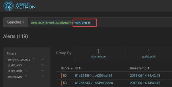

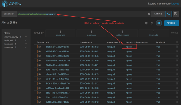

To see all the alerts for a particular domain, click the domain name.
The Alerts UI displays only the alerts with the selected domain name.
To remove a filter, click x next to the filter.
To view all events, click x on the Searches field.
