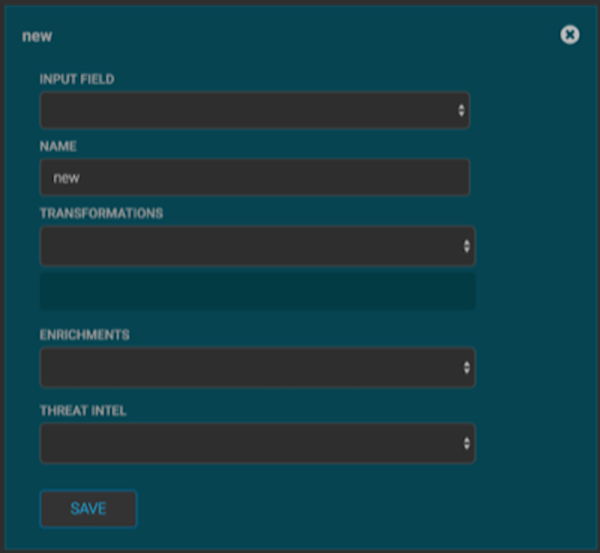

Typically users store transformations in a new field rather than overriding existing fields.For both options, the Management module expands the panel with a dialog box containing fields in which you can enter field information.
In the dialog box, enter the name of the new field in the
NAME field, choose an input field from the INPUT
FIELD box, and choose your transformation from the
TRANSFORMATIONS field or enrichment from the
ENRICHMENTS field.

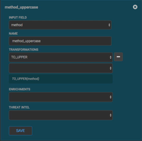

For example, to create a new field showing the lower case version of the method field, do the following:
- Enter method-uppercase in the NAME field.
- Choose method from the INPUT FIELD.
Choose TO_UPPER in the
TRANSFORMATIONS field.
Your new schema information panel should look like this:
