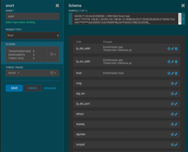

The Management Module displays the sensor panel for the new sensor. -
In the Schema box, click
(expand window button).
The Management user interface displays a second panel and populates the panel with message, field, and value information.
The Sample field, at the top of the panel, displays a parsed version of a sample message from the sensor. The Management UI will test your transformations against these parsed messages.You can use the right and left arrow buttons in the Sample field to view the parsed version of each sample message available from the sensor. -

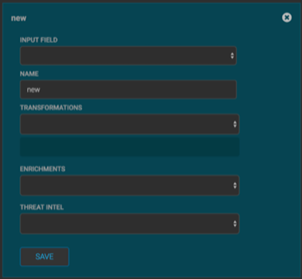

You can apply transformations to an existing field or create a new field. Click the
(edit icon) next to a field to apply transformations to
that field. Or click
(plus sign) at the bottom of the
Schema panel to create new fields.
Typically users store transformations in a new field rather than overriding existing fields.For both options, the Management UI expands the panel with a dialog box containing fields in which you can enter field information.
In the dialog box, enter the name of the new field in the
NAME field, choose an input field from the INPUT
FIELD box, and choose your transformation from the
TRANSFORMATIONS field or enrichment from the
ENRICHMENTS field.

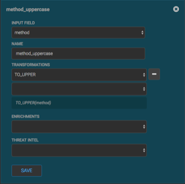

For example, to create a new field showing the lower case version of the method field, do the following:
- Enter method-uppercase in the NAME field.
- Choose method from the INPUT FIELD.
Choose TO_UPPER in the
TRANSFORMATIONS field.
Your new schema information panel should look like this:
