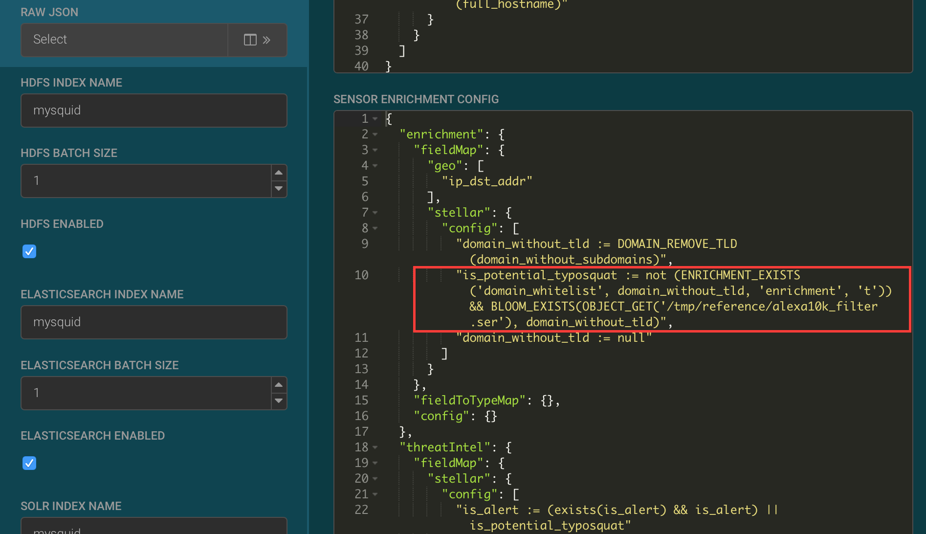

After you identify a potential typosquatted domain, investigate it, and determined
that it is legitimate, you can stop future alerts by using a domain whitelist
enrichment.
In the Management UI, click the pencil icon next to the mysquid sensor.
The Management UI displays the sensor configuration form.
- Click the Advanced button.
Click
(expand window button) next to the RAW
JSON field.
Replace the is_potential_typosquat field value with
the following:
"is_potential_typosquat := not (ENRICHMENT_EXISTS('domain_whitelist', domain_without_tld, 'enrichment', 't')) && BLOOM_EXISTS(OBJECT_GET('/tmp/reference/alexa10k_filter.ser'), domain_without_tld)",

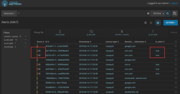

Ensure that the results appear in the Alerts UI.
Enter
cnn.comornsp.comin the browser connected to the HCP proxy. -
Display the Alerts UI.
In the Score column, you should see events with non-zero scores and the is_alert field set to true.

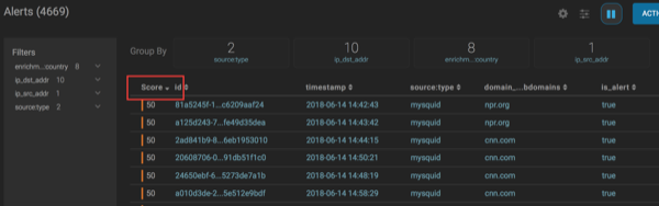

Click the Score header to sort the events ascending by
Score.
Click again to sort descending by Score. A downward arrow appears next to the Score header when sorted descending by Score.

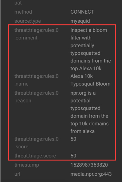

Click between the columns of one of the Scored alerts to view the alert
details.
The fields beginning with threat:triage:rules show the results of all the triage rules. The threat:triage:score field is the aggregated score of the event. If there is more than one triage rule, this field will contain the score combining the results from all the rules. The is_alert field is set only if the triage rules indicate the event is an alert.

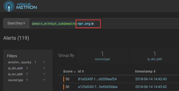

To see all the alerts for a particular domain, click the domain name.
The Alerts UI displays only the alerts with the selected domain name.
To remove a filter, click x next to the filter.
To view all events, click x on the Searches field.
